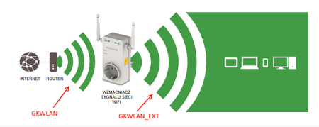

Hello all, my wifi configuration looks like this: NETGEAR genie shows signal strength is 144Mbps. The band used is 2,4 GHz. I can't resolve the issue, that when I connect my laptop to gkwla...

extender's firmware is upgraded to the latetst one. I have made another test: I moved extender to the same room as main router. It was plugged into the wall socket about 2meters from main router. So the distance between these two devices was very short. Even then, when connected to the wifi network from main router, download speed from specific server was like 3.6 MB/s. But when connected to the wifi netowrk from extender, download speed (same server, same file) was around 1,8 MB/s.
For all performed tests I performed, channels with less devices were used (channels were chosen by the main router).

No changes, unfortunatelly. But I've asked on another forum, and it seems, like this is normall extender behavior, as it must send and receive signal with the same antenna (or smth like that).
