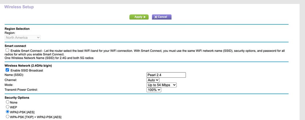

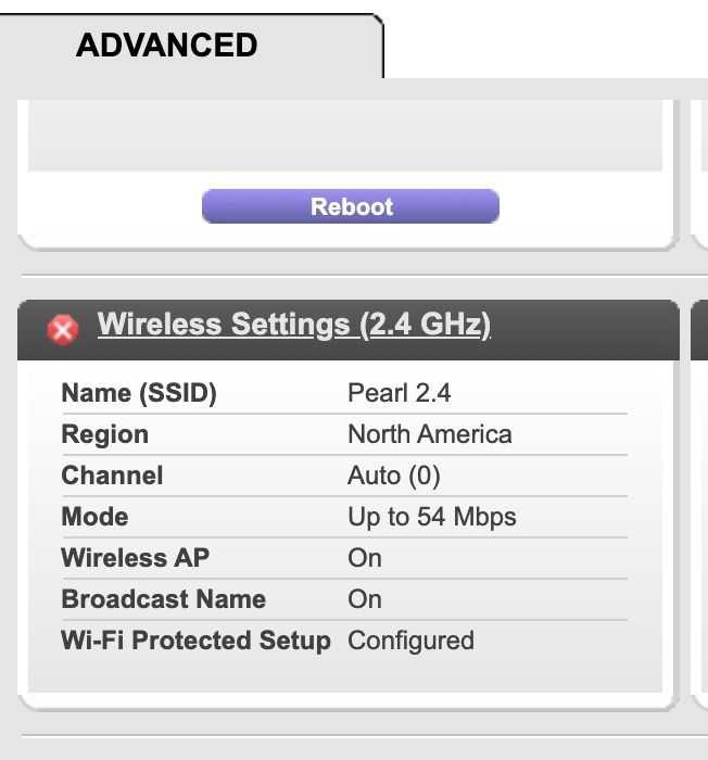

2.4 GHz not broadcasting on Nighthawk R7900P
I have followed the steps listed in this post: Netgear Community 2.4 stopped broadcasting
I still can not get the 2.4 band to broadcast. The light on the Nighthawk 2.4 is on but it is not broadcasting.
I have done a factory rest, using the must current Firmware Version V1.4.1.50_1.3.10 and still nothing.
Need a dedicated 2.4GHz network!
Any assistance would be greatly appreciated.
Here are screenshots:
1 Reply
- plemansGuru - Experienced User
You're not actually on the latest firmware.
I'd recommend installing version 1.4.1.64 of the firmware over a hardwired connection. Then do a factory reset and clean install (not from a backup configuration).
