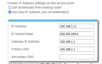

    I avoid that hunt by fixing the IP address of the AP when I put it into AP mode. (Netgear says that this not recommended but does not explain why.) Then I can always get in with that IP address.

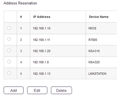

        Netgear doesn't use the "static" word for IP addresses like that.
        You either use a "fixed" IP address when you setup the AP:
        Or you go to  LAN Setup in the router's settings and set an Address Reservation:
