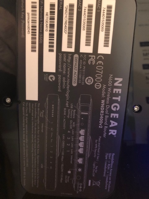

I'm definitely in over my pay grade here.  Doing my best to call things what they should be called.  Below is a screen shot of the bottom of the Netgear10 router.

       What leads you to believe that your WNDR3400v2 lacks "a 2.4 GHz
    network"?

  • So, the method I was using to try to add an (indoor) camera to my SimpliSafe home security system was the app on my iPhone.  By the way, the SimpliSafe home security system is up and running great.  No issues with that.
    When I navigate on the SimpliSafe app and attempt to add the camera, it comes up with an error message that says a 2.4 MGhz network is required.
    A friend mentioned to me, after she saw the picture of my Netgear device, that I have a dual modem so it should work for both 2.4 Ghz and 5.1 Ghz.
    Hope this is more succinct about the problem statement.

      > [...] I have a dual modem so it should work for both 2.4 Ghz and 5.1
      > Ghz.
         Dual-band _router_.  Your "Motorola (Wifi modem)" remains a mystery.
      But, yes, your WNDR3400v2 is a dual-band router, so it should allow you
      to connect to it using either radio band.

         Unless you disabled it, your WNDR3400v2 should be offering service on
      the 2.4GHz band and the 5GHz band.  Typically these two services would
      have different SSIDs.
      > [...] Get the User Manual. Read. Look for "Basic Wireless Settings".
         Did you?  Did you see the two (different?) SSIDs when you looked at
      the router's management web site?  Have you tried telling the device on
      which you're running "the app" ("my iPhone") to use the SSID for the
      2.4GHz radio?  If both radios are configured to use the same SSID, then
      you'd need to change at least one of them, so that you can choose the
      desired band on your device.
