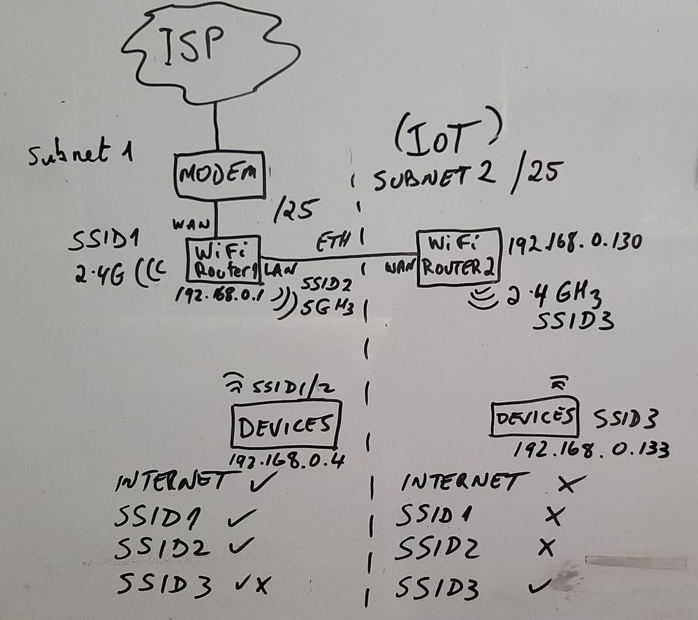

       If you do decide to use the CG3000v2 as a (second) router (presumably
    connecting its WAN port to a LAN Ethernet port on your (unspecified) new
    router), then you'd probably need to configure the CG3000v2 with a
    different LAN subnet (address range) from that used by your
    (unspecified) new router, and then configure a suitable static route on
    your (unspecified) new router, so that devices on its LAN subnet will
    have a chance of getting a message passed to the CG3000v2, instead of
    everything with a foreign-looking destination getting sent to your ISP.

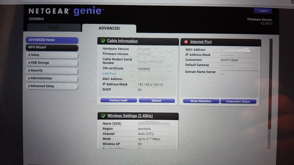

      Hi, Apologies for lack of clarity and information (and assumptions re your psychic powers), I wasn't even sure I would get a response, let alone such a fast one, thank you.
      I attach a diagram of what I am trying to achieve with two subnets, one on each router. The NetGear is WiFi Router2 in below diagram and Sagemcom  (new) is Router1
      The tick marks are ping results. From Subnet1 to SSID3, I am able to ping 192.168.0.130 but not 133.  I suspect 130 is a second IP address for Router1.
      The Advanced Home screen of the NetGear router is as shown below. I don't know where to set the Default Gateway address (which should be 192.168.0.1?). I guess it cannot get an IP address without that since it will use it for DHCP? Maybe I need to set this as static, as you seem to be suggesting in your final comment?  Anyway, thanks again for your help and I will continue my quest.

        I think I need to somehow assign WiFi R2 a static "internet" address from the WiFi R1's subnet. And then set the Gateway and DNS address to that of WiFi R1.
        However, these options are not availabe in the WAN Setup or Internet Setup tabs on WiFi R2 (NetGear). Is it possible that the ISP has disabled these options? Or that it is not configurable on this router model and I need to purchase one that does have them?
