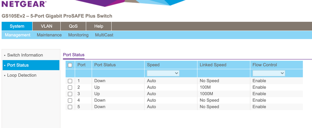

GS105E linked connection limited to 100M
Hi
I have GS105E with 5 ports. Four of the ports are working at 1000 although the one connected downstairs to my router is only connected to 100M. I've checked with the manufacturer of the router and they confirmed its a 1000 ethernet port capable of carrying 1GB /s.
Does anyone know why this isnt doing 1000M?
  • Your a legend. It was the cable, my cable tester showed 1-8 good with the exception of no.7 not lighting up indicating a problem. Pulled it out of the wall and it was slighly nicked and hanging loose. I would have thought it would've killed the connection but no, it reduced it like you said to 100. Flying on 1000Mbps now although for some reason I cant see the switch IP address on my router. Maybe takes time to propagate.
    Thanks!

    If you move the cable from port 1 to port 2/3/4, does it connect at the same 100mbps on those ports? or does it connect at 1000mbps.
    checking to see if its a port issue or an issue with the cable/router.
    You could also try bringing the router next to the switch and connecting it with a known good cat 5E or greater cable.

      Yes it does. I moved it from port 1 to 2 and still 100.

        So its not the switch.
        Its either the cable you're connecting with or the router.
        Easy rule out for the router is move it next to the switch (or the switch next to the router) and use a known high quality cable.
        if it connects at gigabit speeds, then it'd be the cable you were using prior. If thats the case, you can try redoing the ends on the cable. A bad end can give you a 10/100mbps connection and not gigabit. Plus check the cable to ensure its at least cat 5e
