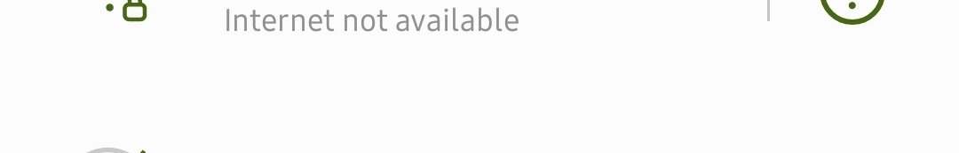

I recently had to upgrade my router according to a Spectrum representative, and I was sent an Arris TM1602A modem. I currently own the Netgear AC1900 modem router and have tried connecting them via an ethernet cable. Both devices power up fine; however, it will not let me connect to the Wi-Fi.
I've contacted representatives at Spectrum, and they've said that everything was fine with the modem and that it's probably something to do with the netgear device. I've attempted to only turn on my modem router, but that doesn't work either. I've also tried to power cycle and reset the devices to no avail.
