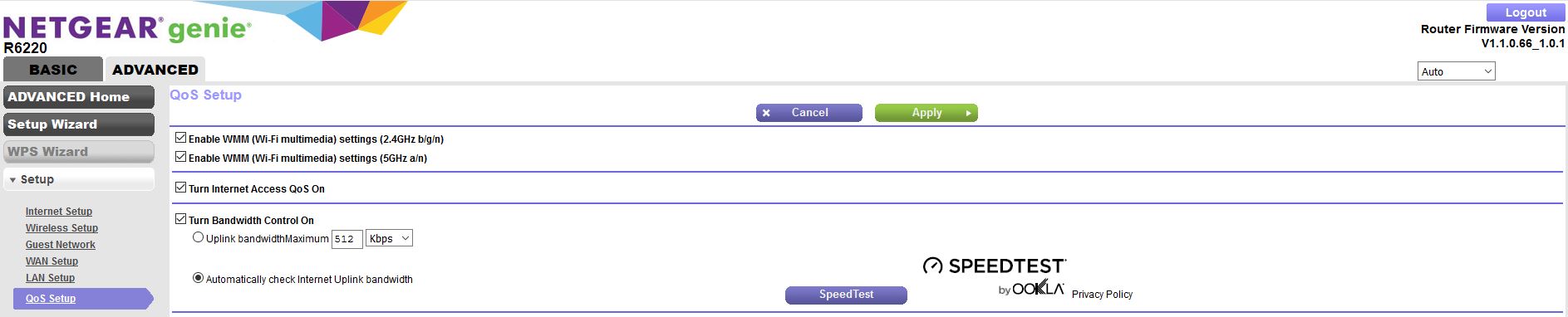

    Thank you for your reply, I called my ISP to check the Fibre Modem and whatever it called actually they told me it's a EPON ONU.
    Finally they told me The Router and the Fibre Modem both are okay, but they find a issue in Router QoS Setup / Turn Bandwidh Control On option (Cheacked) and selected with Automatically check Internet Uplink Bandwidh, after disabled Bandwidh Control option Connection Drop fully disappear.
