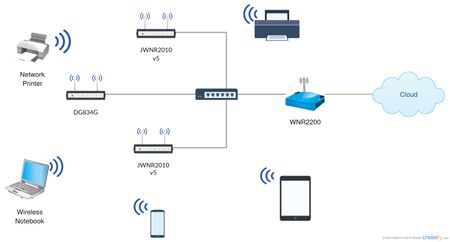

JWNR2010v5 Guest Area with connection LAN to LAN
Hi to all, I'm using my JWNR2010v5 as access point conected in a LAN to LAN mode with a WNR2200 which is directly connected to internet. I would like to create a connection for guest only to acc...

Hello ElaineM,
before you told me to check that option and I told you that with that option the guest will see the whole LAN and in the last post you wrote that if I want to obtain the security level I want, I haven't to select the same option..... could it be you answered too much fastly?
Is there in this forum any one who can answer me if I can hope in a simple "AP mode" option selectable to obtain what I need? I think it wouldn't be so complicated. I think it could reached simply releasing a firmware update.

While all these consumer class routers (talking of your WNR2200 as well as the JWNR2010v5 and most likely your 3rd party device) are offer a simple Guest WiFi network configuration (in router mode only), with limited network segregation (only Layer 3 data filtering), there is no way this guest network can be extended - not over the Ethernet, not over a WiFi bridge or wireless extender or whatever. The same concept is (ab-)used also on Netgear Orbi platform, on the simple WAC with it's (optional) router mode.
Technically you could disable the JWNR2010v5 DHCP server, and configure a dedicated static IPv4 address for each, and just connect the switch LAN port(s). Lack of a default gateway, the JWNR2010v5 itself wont have access to the Internet - as there are unlikely new firmware updates coming, time and date wont' be properly set. But it would act as a pure wireless access point.
Even if there would be a WiFi AP mode config for the JWNR2010v5, there would be only one SSID - or if there would be a Guest SSID (I don't know) - all will connect to your switched L2 network - so this would not help you either.
DanielPaviotti wrote:I think it wouldn't be so complicated. I think it could reached simply releasing a firmware update.
Not complicated probably - I doubt this is worth all the effort for this pre-historical WiFi technology. And it won't help you as explained above.
There might or might not be Open Source like DD-WRT firmware permitting to properly configure multiple SSID on the WNR2200 and the JWNR2010v5, bridging these to a dedicated VLAN (or at least to a dedicated Ethernet port) and run different TCP/IP subnetworks on both VLANs resp. individual networks. This would be more a project for hardcore IT pros or students 8-)
If you want to operate your primary (W)LAN over multiple access points, and provide (W)LAN access for guest in a dedicated network, there is no way around the deployment of Internet router able to deal with multiple security zones (VLANs) [Note: Netgear has .. none!], probably a VLAN capable GbE switch (consider PoE), and finally some wireless access points permitting multiple SSIDs bridged to dedicated VLANs as ie. the WAC510.
Your requirement is not uncommon - just the mainstream vendors ignore these requirements for years, they continue offering "consumer" routers with specs form the early 1990ties. It's a shame Netgear does not really offer a solution for us here. Mi dispiace, I would like to give you a better answer for your plan.
Regards,
-Kurt
PS. Please don't blame ElaineM - your question was certainly somewhat off her comfort zone because this functionality does not exist on Netgear's Home Network / WiFi Router offings she does care of here.
