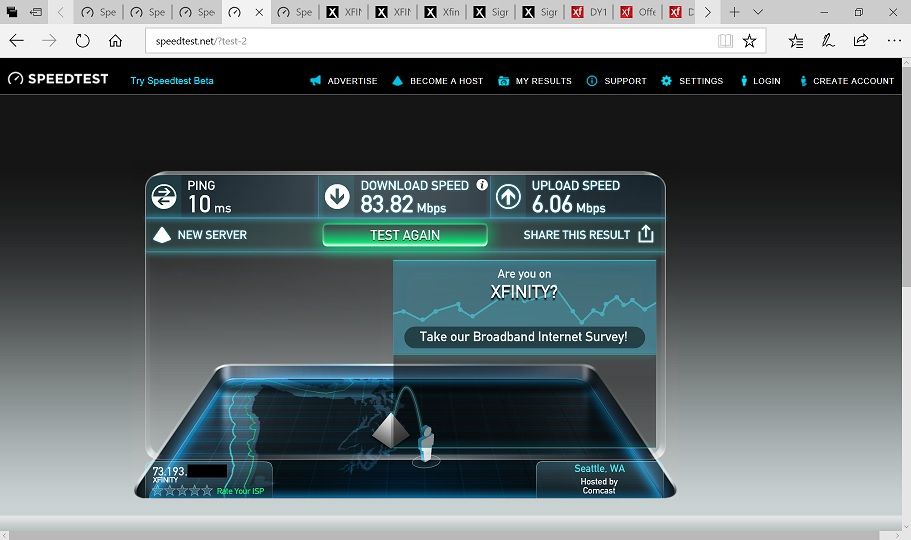

N300 router with latest firmware, Arris SB6141 cable modem. Modem dies, replaced with an SB6183. But the N300 couldn't talk to the SB6183, couldn't get an IP address. So at the suggestion of the Comcast tech I reset the router. And that worked! Sort of. I mention this becase the router has already been reset (a common suggestion in "fast/slow" threads). Everything WiFi is now dead slow.
Here's a WiFi speed test from speedtest.net. Yes, that's 0.61 Mbps. Dead crawl!

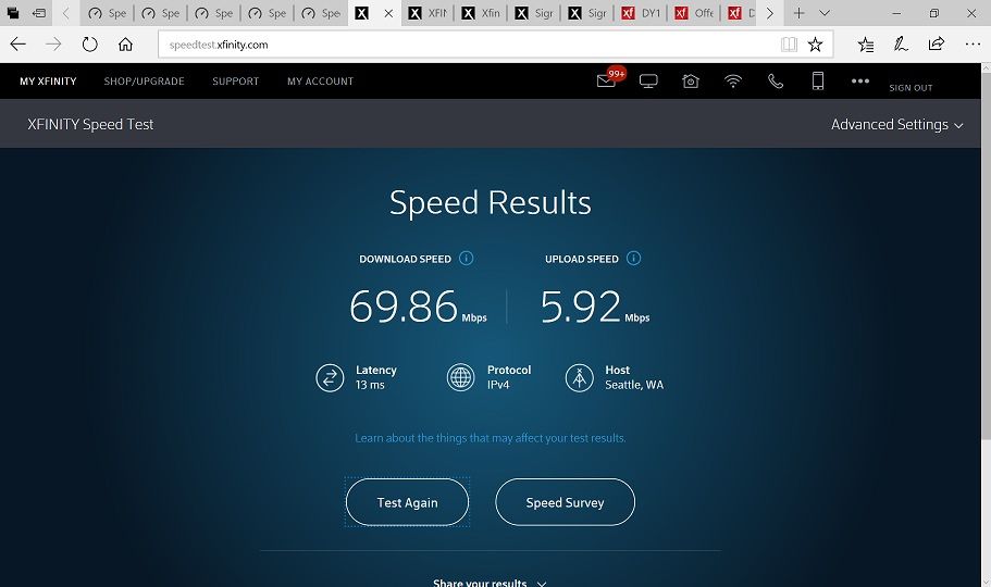

And here's another WiFi test, from Comcast. Yes, that's 100 times faster.

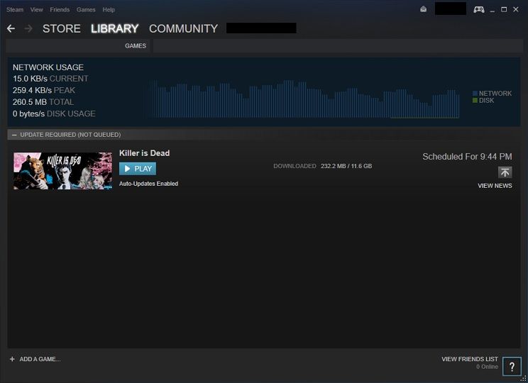

And here's a real world example, trying to download a Steam game. 259.4 Kilo bytes per second peak! Peak! I'm paying for 100 Mbps!

- NeedleroozerAspirantAh ha! A clue! Comcast speed test lets you choose IPv4 or IPv6. IPv4 is fast, IPv6 is as slow as the speedtest.net tests. So, how am I _supposed_ to configure IPv6, because clearly the router reset defaults aren't working.
- michaelkenwardGuru - Experienced User
Find out which type of IPv6 Comcast uses and see if you can set your WNR3500Lv2 to that.
There is a manual for the WNR3500Lv2 somewhere at the end of this link:
>>>> WNR3500Lv2 | Product | Support | NETGEAR <<<<
See page 91.
After trying the entire list, the last setting - "Auto Config" - worked for Comcast's speed test. It's now 50-60 Mbps for either IPv4 or IPv6.
