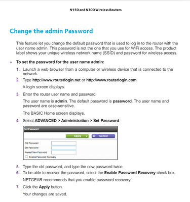

    Always a good starting point is the fine product documentation, eg. from https://netgear.com/support or direct the Netgear N150 and N300 Wireless Routers User Manual

      Thank you for your very detailed instructions. However, I am not quite sure how to interpret it. (I have now found the password that was assigned to my Reset router). I have been accessing my wifi  successfully with the SSID NETGEAR and Password that was assigned after resetting the router. So my question is:
      The default username (admin) can typically not be changed.
      Your instructions are give below How to change Admin Password - so I don't quite understand your statement (in Italics). I just want to create/assign a New SSID of my own as well as generating a new password of my own. Can this be done?
      Thanks for any additional answers to my question.

        • the password that gets into the router through a web browser and the graphical user interface (GUI) with the username admin. (You can't change the username.)
        • the password that connects to its wifi through the SSID
        schumaku has given you the instructions for changing the admin password.
        You use that to get into the GUI, preferable with a wired connection. When you have done that you can change the wifi settings to whatever you like.
        How do I change my NETGEAR router password or network name (SSID)? | Answer | NETGEAR Support
