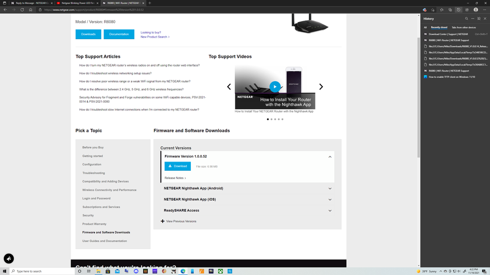

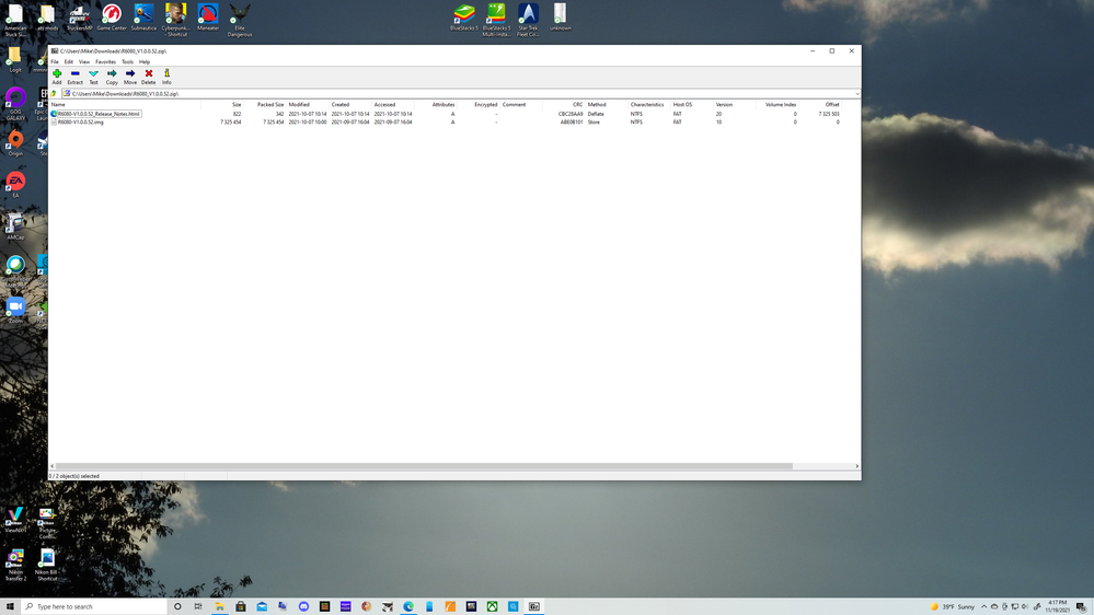

Okay so here's the issue unit is out of warrnaty 1 week ago,, Now it won't work.... I tried to do an update on the router using the Nighthawk app. Now the power light just blinks green, none of the other status lights come on.... YEs everyhting has been tried, and I do not want to pay 40 bucks for support to tell me to try everything I already did... I was hoping maybe one of you all had a similar issue and possibly got your router up and running again...

You can try recoving it with tftp or nmrpflash.
are you on windows? if so, follow this guide
https://kb.netgear.com/000059634/How-to-upload-firmware-to-a-NETGEAR-router-using-Windows-TFTP
just make sure you enable tftp
https://www.thewindowsclub.com/enable-tftp-windows-10
and here's a video walk through using a tftp client. Use the built in one for windows 10 though. the video is more of an example of how its done.
https://www.youtube.com/watch?v=R9DLrLQrpaw
and if that doesn't work, you can try using nmrpflash
https://github.com/jclehner/nmrpflash - mnmacdGuide
