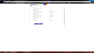

R6020 won't work, in particular Genie by the look of it
Recently got second-hand a R6020 router, which I had to then factory reset. Easy enough. After setting up, I was asked if I wanted to update to 1.0.0.34, which I accepted, which has now led to my cur...
- Sep 13, 2018
Actually have now solved it. Was scrounging around and managed to find a forum saying to access the router through "192.168.1.1", which was different from "routerlogin.net". The next button finally loaded and I was able to proceed to setup.

That's a part of the problem. I can't even get to the settings through routerlogin.net.
- TaterSalidSep 08, 2018Virtuoso
If you reset the router then go to "routerlogin.net" you should have the option to select "do later" I think.
If "routerlogin.net" doesn't work try "192.168.1.1"
