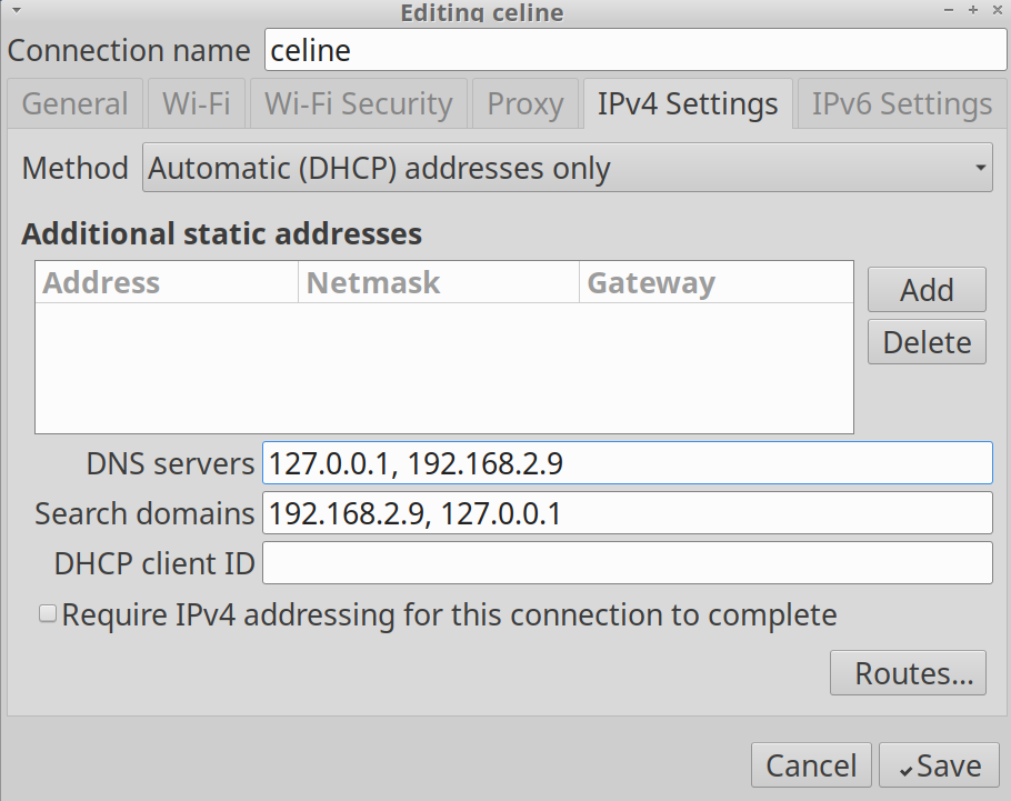

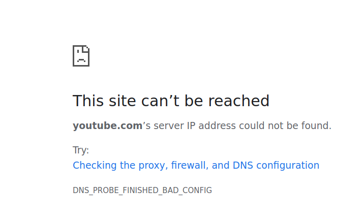

      As i have stated abobe I went under internet setup if I change to my own dns server at 192.168.2.9 I have no internet for the host 192.168.2.9 As in their is no connention. Command line apt update says could not resolve and the web browser says DNS_PROBE_FINISHED_BAD_CONFIG
      I have tested out my own dns sever by using it for years by changeing the ipv4 setting on my wifi card dns servers and search domains to 192.168.2.9. Other computers on the network can still get the internet using my dns server but not the host 192.168.2.9.
      under Lan Setup i have the ip address 192.168.2.9 next to the device name and MAC address saved.
      /etc/resolv.conf
      nameserver 127.0.0.53
      options edns0 trust-ad
      search 192.168.2.9 127.0.0.1
      pihole is on port 53 dns server
      stubby is on port  8053
           You're talking about Address Reservation?  As in:
        ADVANCED > Setup > LAN Setup : Address Reservation?  (Did you notice
        that the most significant part of that, "Address Reservation", appears
        noplace in your description?)
        > /etc/resolv.conf
           On _what_?  Your name server?
           "127.0.0.53"?  Huh?  What's at _that_ addresss?
           Huh?  The "search" option should specify default domain name(s),
        usually one, not multiple IP addresses.
              https://man7.org/linux/man-pages/man5/resolv.conf.5.html
           I can't tell if you don't know what you're doing, or if you can't
        type what you're really doing, or both, or what, but what you've written
        makes no sense to me.

           You might try a "/etc/resolv.conf" which makes more sense, like, say:
        nameserver 127.0.0.1         [or: 192.168.2.9]
        options edns0 trust-ad       [If you want.]
           If you decide to use a local domain name, then you might add a
        "search <my_local_domain_name>" option.
