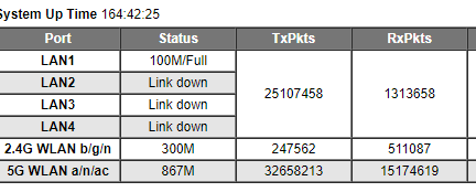

      I think I find the root cause. It seems the WAN port speed is down to 100 Mbps, when I enabled IPTV on LAN1 and link status in 100 Mbps on LAN 1.
      After chaning to AP mode, I can't see the port statistics on WAN port but only find the counters and link speed on LAN ports.
      (But I'm pretty sure the link speed of WAN port is 1 Gbps when using router mode.)
      As you can see there is a device connecting on LAN1, with link speed 100 Mbps.
      And the download speed is increased from 100 to 250 Mbps once I remove the cable from LAN1 or disable IPTV feature on LAN1.
      I'm not sure if this is a expected behavior but looks weird to me.
