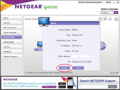

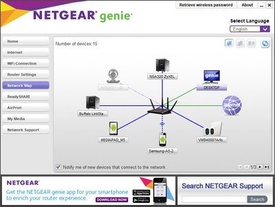

    If you are using Windows, the old Netgear Genie lets you rename devices.
    genie | Product | Support | NETGEAR
    Netgear wants to kill it – which is why it is hidden away on the support pages – but some of us diehards like it. This has a Network Map
    Click a device and then Modify.
