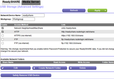

    Have you used a web browser and the graphical user interface (GUI)  to look at the ReadySHARE settings?

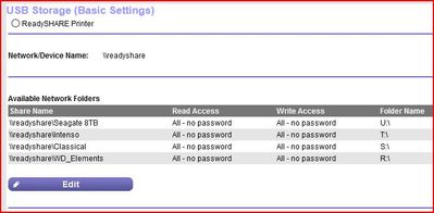

      USB is Topesel 64 GB formatted exFAT
      In Routerlogin.net I simply clicked on USB Storage then ReadySHARE and it does not show any usb devices.
        ReadySHARE does not support ExFAT.
