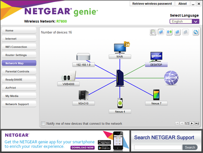

    In addution to tghe advice from plemans, I suggest getting the desktop genie for your operating system:
    genie | Product | Support | NETGEAR
    This has an excellent network map that wipes the floor with the router graphical user interface (GUI) and can even provide a  lockable link that will take you to the IP address, and GUI, of the AP device.
