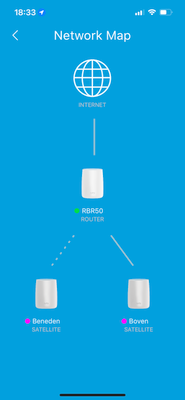

For testing purposes I have connected one with and one without powerline.
Both lights are purple.
However, there is connectivity, because I can connect to the ip address and see this:
All devices (wifi) are connected to the RBR, but when i unplug one of the RBS I can see my laptop go offline and having to reconnect so somehow I think they are connected.
What am I missing here?

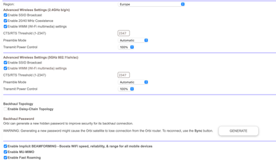

These are the settings for my wifi
Thanks!
Pictures not uploading so link: https://imgur.com/a/ym0asK0

    the color is indicating a poor connection.
    https://kb.netgear.com/000061800/What-do-the-lines-and-colors-in-the-Orbi-Network-Map-mean
    powerline isn't the best as many things can cause interference for it.
    What color do you get if you connect an ethernet wire between the router/satellite?
    (you can get a pretty long ethernet wire for pretty cheap)
    Try connecting them to test out the connection. If it works fine, it indicates your powerline is the issue.
    Thanks!
