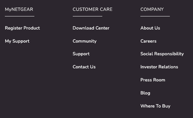

Well, I bring up the page using browser on laptop computer (192.168.68.108) connected to the same network as the Netgear WNDR4300 router (192.168.68.2), but no pop-up login window appears.  In fact, I cannot see anywhere to login:
Anyone know why the pop-up login window does not display?

    That IP address hints at something else on your network that is controlling the traffic. By default your WNDR4300 would go for 192.168.1.1. Feed in www.routerlogin.net and it would look for that.
    What you see is probably tour browsers attempts to make sense of a Netgear address. It has instead take you to the Netgear.com site.
