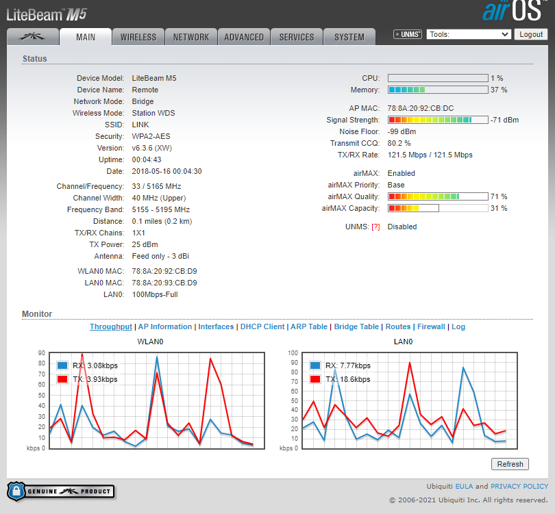

      • ramdino's avatar
        ramdino
        Tutor
        Update, I figured out how to get to my dish dashboard. I updated the firmware and here are my results
        Looking at the TX/RX rate on my receiving unit I should be getting good speeds if I am reading that correctly. I don't get why the graphical is in Kbps rather than Mbps. Still have slow speeds , down to 3Mbps at my devices now.
