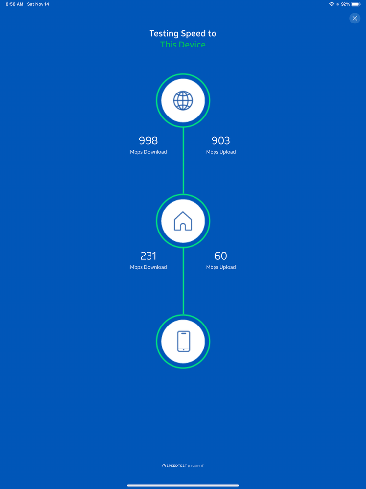

Slow orbit broad cast speeds
I have reallly fast speeds coining into my AT & T modem, but the speed coming out of my ORBI WiFi is much slower.  Can someone help?
I have the router WiFi broadcast turned off.  I've attached a speed test I performed with the AT & T app

    A couple things.
    1. pictures have to be approved by a moderator. it can take a while. If you want that info viewed, attach it as a file. Or just type the numbers out. we'll believe you.
    2. What att gateway do you have? Most have integrated routers and cause a double nat. https://kb.netgear.com/30186/What-is-Double-NAT
    Turning off the wifi doesn't shut off the routing capabilities.
    3. how are you speedtesting? over wifi or hardwired? make sure to test hardwired.
