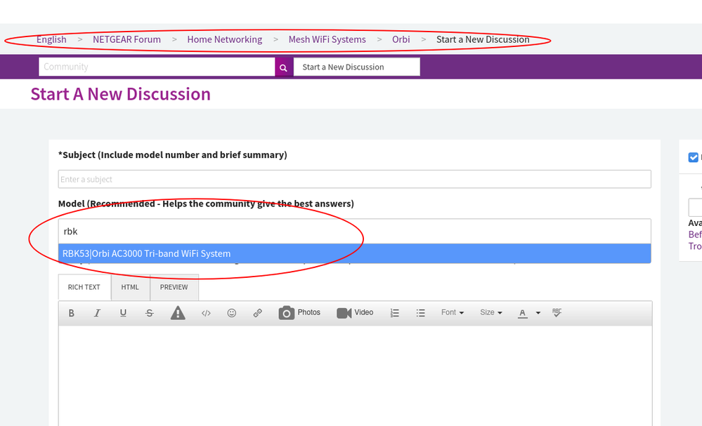

My firmware version is V3.2.18.1_1.4.14. My model wasn't available in the dropdown menu above, but I have the RBK853 AX6000 (Amazon link). Main router plus 4 satellites.

Ah I see. The "Start a New Discussion" link from the forum home page takes you to the Nighthawk WiFi Routers.
I guess I shouldn't be surprised that the Netgear forums are a mess after experiencing the utter carnage of the Orbi software...
I'll move my post.

Actually the model select options appear to be the same. Still no RBK853.
