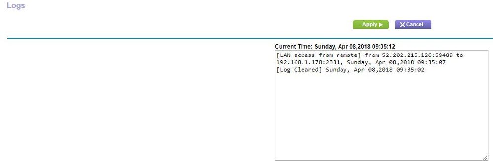

I set up port forwarding TCP/UDP. (Added a Custom Service and forwarded external 2331 to the same port internal on 192.168.1.178). I test this by going to canyouseeme.org and having it check port 2331, and then looking at the Router Logs. The logs actually show it being forwarded:
[LAN access from remote] from 52.202.215.126:58819 to 192.168.1.178:2331, Sunday, Apr 08,2018 09:29:48
But when I hit <my public IP>:2331, I still get nothing (connection timeout). I'm at a loss for what to try next to figure out where these packets are being dropped...?  Thanks in advance for any help/pointers.

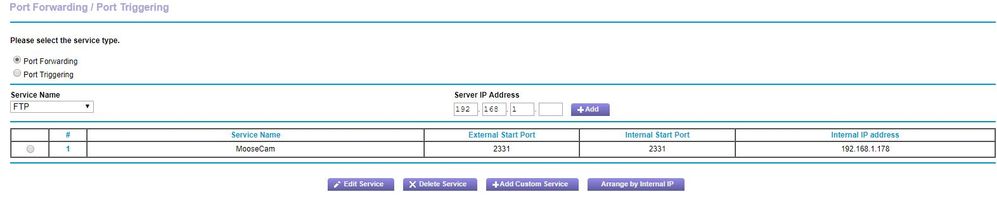

    > I set up port forwarding TCP/UDP. (Added a Custom Service [...]
       That sounds ok to me.  Copy+paste of the actual rule would be
    reassuring.
      reassuring. As I write, the in-line pictures are still obscure, waiting for
      moderator approval.
      The pic is a screenshot of the rule, but I'll try pasting the table here:
       #Service NameExternal Start PortInternal Start PortInternal IP address
        1MooseCam23312331192.168.1.178
