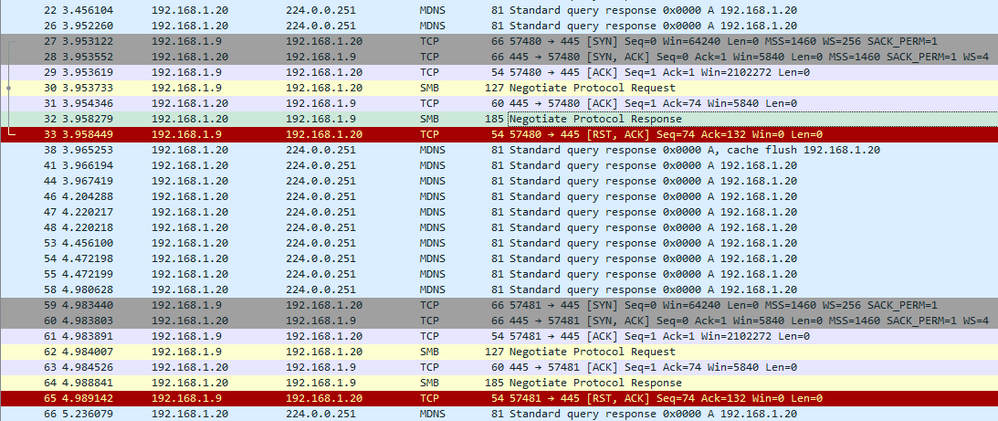

    • ggarner1995's avatar
      ggarner1995
      I already use the DHCP address reservation to reserve 192.168.1.20 as the address, so the Orbi's DHCP will always assign that address. As for name resolution, it's not actually the problem (the broadcast is used to resolve the local hostnames), but you're correct that this has nothing to do with the wireless ports. It still happened when I connected the computer over the wireless.
      I decided to capture the traffic with wireshark and here is what I found (first column time; r6220 is 192.168.1.20, and I'm 192.168.1.9):
      Wireshark
