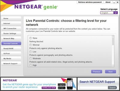

- on desktop genie, then parental, i am having this error as i reach the OpenDNS sign in window as shown below

    • panikyo19's avatar
      panikyo19
      Hi DexterJB,
      thanks for the quick reply from you sir,
      - and as you instructed, i did a factory reset on my router
      - just for info, i have not done that after i upgraded my router firmware
      - router rebooted itself after factory reset
      - try to have a backup on your current settings, to make it easy for restoring after the reset
      - then at last, i was able to access this window below from desktop genie, in which, before i was having an error window message, as seen on my first post.
      - after saving your parental settings, it won't effect right away, need to wait a few minutes before it will take effect ( in my case)..
      - and now it works..!
      thank you so much , fearless leader DexterJB, on your expert advice...
