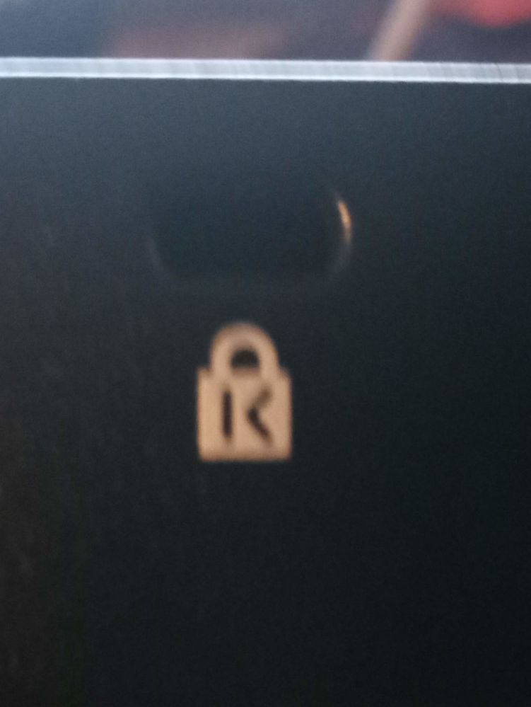

And what is this for? A secret feature?WHAT IS THIS FOR ?
I uploaded a picture here of the HOLE on the back with the PADLOCK symbol , but alas, it has disappeared.
         In-line images must be approved by a moderator before others can see
      them.  The time required varies.  Attachments have no such limitation.
      Of course, attachments have their own one-per-message limitation.
         Assuming that your picture agrees with the picture in the product
      literature, I'd guess that it's an attachment point for a
      theft-prevention device.

  • michaelkenward's avatar
    michaelkenward
    DAN
    Look for "Kensington lock" in the manual.
    It is a standard feature on a lot of kit.
    • antinode's avatar
      antinode
      Guru
         You first?  In exactly which "the manual" did you find that
      information?
