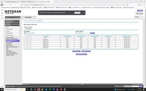

8000P Port forwarding issue
I have opened port 9100 on several IP's internally but when I try to access the port form the public IP the Port is not opened?? Screen shot below of my issue, I have one port for my cameras that ope...
- Aug 11, 2025
This appears to be set up correctly. connecting to
<public IP>:9101 should connect to 192.168.1.240:9100
<public IP>:9102 should connect to 192.168.1.241:9100
etc.

- robinjamesshortAug 11, 2025Aspirant
Thanks, I know the public ip is good as I can see the port 37777 is open and broadcasting correctly for my cameras, the issue if the 91xx ports that are set up in the same manner but the ports come back as blocked ??
