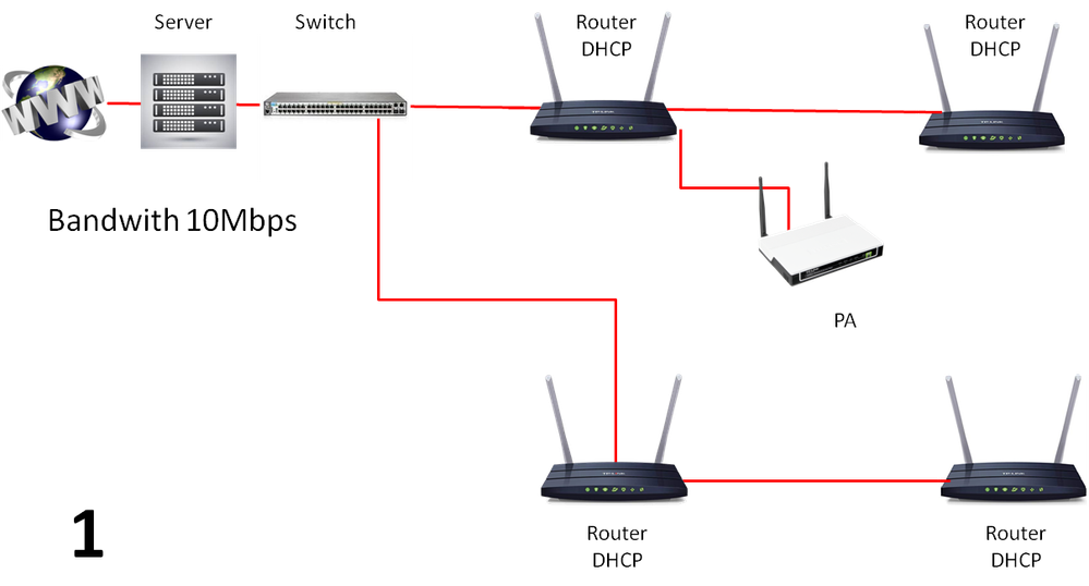

Jan 09, 2019Aspirant
Hello
I try to explain my situation, for that i have made 2 diagrams. ,Diagram 1 is the situation before my incoming in the school.
The internet network was made from a connection with a bandwith =10Mbps trough routers et one PA , the DHCP was activated on each router, then each router made his own network with his DHCP.
