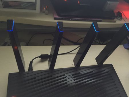

Amber light on power lamp R8500
Amber light on power lamp R8500 The same is true when pressing the RESET button. http://www.routerlogin.net It doesn't connect. Please help me.

Normally the power light showing amber color means there is a problem with the way the router booted, may be a firmware problem of some type but something is stopping the router from fully booting up.

Hi barkhunil,
Try this KB article to load the firmware.
https://kb.netgear.com/22688/How-to-upload-firmware-to-a-NETGEAR-router-using-TFTP

I tried hard to use the R8500.
But 192.168.1.10/255.255.255.0/192.168.1.1
Only the orange lamp turns on
It does not blink.
The router is very hot.
It's hot enough to hurt my hands.
It's hot enough to fire up.
I can not turn it on.
