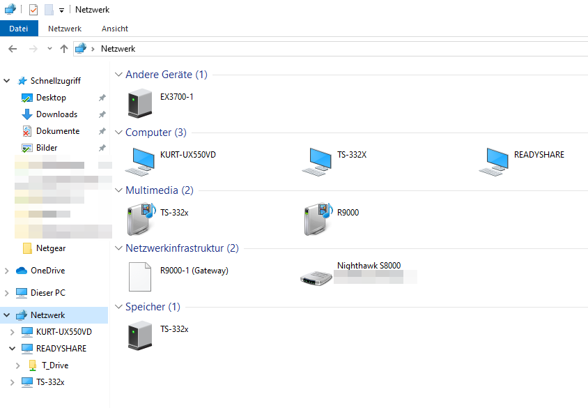

      • schumaku's avatar
        schumaku
        Netgear is still stuck (on the routers, extenders, ...) to NetBIOS device discovery and name resolution, and most of these consumer devices don't support anything but SMB 1.0 transport protocol. Both requires having the SMB 1.0/CIFS Client feature installed on the Windows 10 system. Plus the network location must be set to a private - not public - network. So we're still waiting for current SAMBA sharing file system support, and the addition of WS-Discovery - and htis feature would not be required.
        Once done so, the router READYSHARE (or however it was renamed) should show up in the Windows 10 Explorer in Network - from here you can browse to the shared folders, no need to find the configured shared folder names:
        Sometimes, it does not show up immediately here, it can take a minute or so after connecting to the network. You can manually enter the \\readyshare (casing does not matter) in the Start menu or direct in the Windows Explorer.
