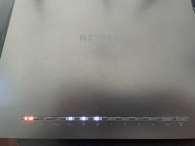

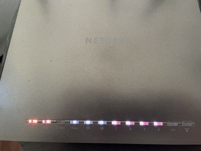

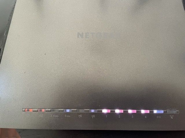

Blinking white and amber
I woke up in the morning and found that the router is not working. No device is connected. I checked the device I found that the routre power leds and eathernet connection leds are bliking alternative. white and amber. I tried factory reset, I tried flushing with tftp. It doesn't do anything, as soon as I turn it on, it starts blinking. Does anyone know what might be the issue?

      Hi,
      Thanks a lot for your quick response. I tried many times to do a factory reset. Followed 30/30/30 and I was not able to reset.
      Then, I tired tftp. I followed everyting that the youtube showed. However, the tftp failed with error saying unable to connect the device. Looks like I can't make the device to connect no matter what I do.
      Is there any other suggestion?
      Thanks in advance.
