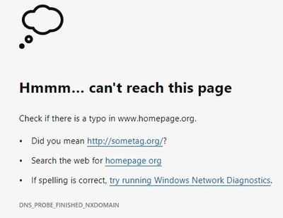

Hello!  I allowed my R6700v3 (AC1750) router to install the latest firmware update (V1.0.4.120  10.0.91) a few days ago.  Ever since then I've been experiencing slow connection to several web sites and IMAP syncing issues when I open MS Outlook.  The computer is connected to the router by wire (not Wi-Fi).  If I bypass the router by plugging the feed directly into the computer, all problems go away.
Does anyone have any suggestion?  Is there a way to roll back the update?
