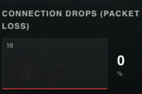

Help! My Nighthawk R7000 has more packet loss than my cheaper wifi router.
I have been trying to play Shadow PC with my Nighthawk R7000 thinking it would be an upgrade to my Honor Router 3 but I was shocked to see that the Nighthawk R7000 which is twice the price has so much packet loss compared to 0% with the Honor Router 3.
Both are on factory defaults. Do I really have a better router than the R7000? I'd prefer to not use a router by Huawei but I'm shocked that a $125 gaming router is out performed by a $70 casual router.
Is there a router setting I need to enable/disable? I am using factory default.
See attached screens for graphs. The one with packet loss is the Nighthawk.
Nighthawk PacketlossHonor 3 No packetloss

My modem is the factory default provided by vodafone. I'm not sure what it is. All I have to go on is logically A/B testing two different routers through the same modem with widly different results points to the Nighthawk underperforming. Also, there are no other devices connected to the network when testing.
I should also note this is going through my Macbook over 5ghz. The surprising thing is that a speedtest.net will give nearly identical results of 250 mbps on both the R7000 and Honor 3.
