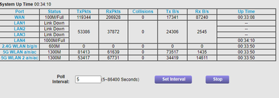

How can I change the WAN port of my x6 R8000 to 1000M from 100M?
I bought R8000 several years ago when I was using a 100M network. Now, I have upgraded the network service to 1000M. I am getting no more than 100M speed in the Speed Test. I entered the router administration page and found the WAN port status is 100M/Full.
I unplug the cable and plug it into a new router the ISP provided me. It works with 1000M speed.
I have tried several ways I found in the community, but no luck. It still does not work. How can I resolve this problem?

- Model: X6 R8000
- Firmware: V1.0.4.84_10.1.84 (I have tried to reset to factory settings or upgraded the firmware to the latest version)
- Moden: support 1G
- Cable: CAT-6
- QoS is disabled.

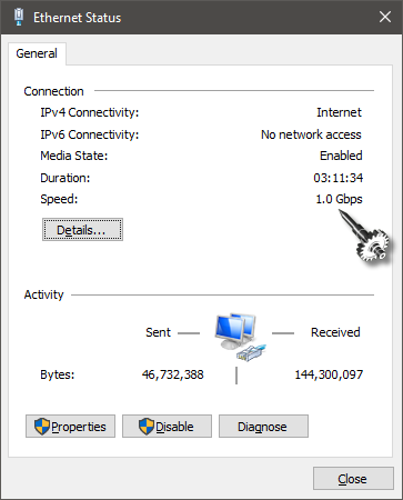

    As a quick test, connect a wired PC to the WAN port on the R8000 and look at the connection speed seen on the Status option window in Windows to see if the PCs ethernet is connecting at 100Mb or 1Gb.
    • ardy_chen's avatar
      ardy_chen
      Got a result for your recommendation of "quick test", it is 100M. Does it mean the WAN port of the router only supports the connection at 100M?
