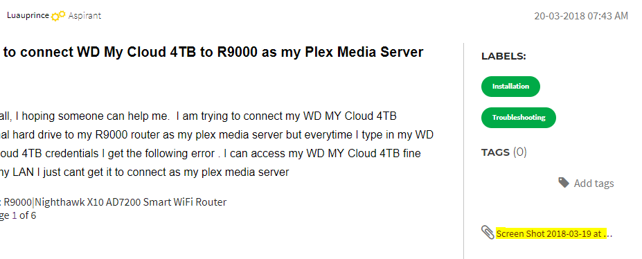

How to connect WD My Cloud 4TB to R9000 as my Plex Media Server
Hello all, I hoping someone can help me. I am trying to connect my WD MY Cloud 4TB external hard drive to my R9000 router as my plex media server but everytime I type in my WD MY Cloud 4TB credentia...

The error I was getting was "Your router can't connect to your network drive because your network drive credentials are incorrect." I know all my credentials are correct.
