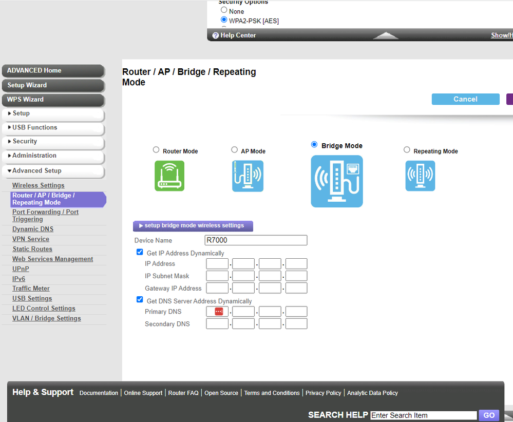

How to set up wireless bridge in R7000
Netgear R7000 with firmware V1.0.11.134_10.2.119
My main modem/router is in the middle of my house. I would like to add my R7000 in my office to give internet to a Windows 10 desktop and a VOIP box. To accomplish them, I read I need to connect the R7000 to the VOIP box and to my Windows 10 via ethernet wires and set the R7000 in wireless bridge mode. Here are my settings:

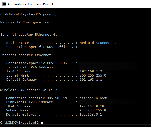

- Modem/router: 192.168.0.1
- R7000: 192.168.1.1
- Windows desktop (via ethernet): 192.168.1.2
- Windows desktop (via wireless adapter): 192.168.0.20
Here are my ipconfig settings:
I am uncertain whether to leave the R7000 settings bridge below as is or change them. I have tried this process a few times with a previous firmware and I end up not being able to get into the R7000 and my Windows 10 desktop gives me ethernet messages like Ethernet does not have a valid configuration.

It works. The trick was to click Setup bridge and then nter the SSID and password for main router/modem. After restart the IP changed for R7000. It is now http://192.168.0.24. I found this out by visiting the maim router/modem at 192.168.0.1 and looking for the R7000 in the list if connected devices. Now I need to see if the R7000 with this version of firmware and in Bridge mode will have the same problems as before. If so, my next step is to try Asuswrt-Merlin (firmware file RT-AC68U_386.7_2.trx).
