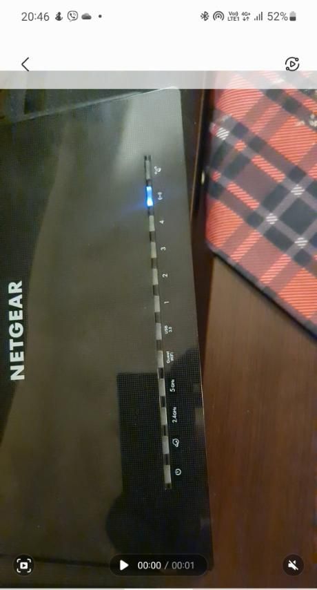

I lost wifi connection at all
Suddenly all the lights on the Wi-Fi are off.
only one light is on: Wi-Fi on/off button
To make it clearer I am uploading a picture.
Please tell me what I can do to fix it?
power light is off in general but sometimes very rarely it is blinks

      • levaneliz's avatar
        levaneliz
        I have net gear ac1750
        it has started suddenly. I don't know why.
        It has been working without any trouble for a long year. 8 years minimum.
        It is connected to the gateway of the internet provider from the beginning, and nothing has changed.
      • michaelkenward's avatar
        michaelkenward
        If the power light doesn't come on, that suggests dead hardware.
        If you have a compatible powder adapter lying around, they are pretty common, try that. Any generic adapter will work, as long as it has the right volts, enough amps and a tip with the right (+/-) polarity and dimensions.
        If that does not work, then it may be time to recycle your eight-year old router.
        By the way ac1750 doesn't tell us which router you own.
        ac1750 is not a reliable guide to model number. Many devices come with an AC tag, but it is essentially a label that Netgear, and other brands, attach to hardware to describe wifi speeds. Look at the label on the device for the model number.
