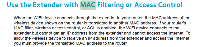

      One strange thing I have observed with some WiFi Extenders is that they invent new MAC addresses for devices which connect to the WiFi Extender.  For example, page 31 of the Netgear EX3700 WiFi extender User Manual says this:
      In this case, the WiFi Extender is not acting as a DHCP server.  Rather, because the device MAC address has been changed, it no longer matches the value that was defined in the router address reservation table.  (This caused me quite a bit of frustration as I had carefully tested that a device got the correct IP address when connecting it directly to my WiFi system and then was very annoyed when I took it to a remote location and plugged it into the WiFi Extender and it got a totally different IP address.  WTF??? - much swearing.)
      It might be interesting to look at the user manual for this TP-Link Access Point.
