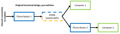

I am working on upgrading my wireless network to include wired connections for high-demand devices.  The primary router that I am using is an ISP-provided Plume mesh WiFi router.  I had previously purchased a Netgear Nighthawk R7000 and am/was pleased with the WiFi range.  I previously had my R7000 integrated into my home network as such:

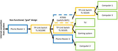

As I was looking to expand my wired network while maintaining the WiFi range of the R7000, I ran some additional ethernet cables and purchased some switches, to change my design to look as such:
In the original design, I had the R7000 set to access point mode with the source ethernet cable plugged into the WAN port, the computer plugged into a LAN port, and the second Plume router plugged into another LAN port.  This system worked.
After the switches and changing nothing else, the network no longer functions.  I have a WiFi connection at my original router, but I have no WiFi or ethernet connectivity downstream in the system.  I have tried resetting and re-setting-up my R7000 in access point mode.  I have also tried setting up the R7000 using a static IP, disabling DHCP, and using a LAN port as recommended in this community post: https://community.netgear.com/t5/Nighthawk-WiFi-Routers/WAN-OR-LAN-Port-for-Access-Point/m-p/1066752/highlight/true#M29745.
The reason I suspect that the problem is with the configuration of the R7000 is that, even though I was able to get the original design functional, it took some finagling (unfortunately, I do not remember exactly what I did not make it work; not that this matters because these settings did not work in the new design).  In the new design, when I remove the R7000, the network is usually functional.
I appreciate any insight that can be provided.

    After getting some sleep and starting fresh, I tried a clean reset of the TL-SG108E switch and the R7000.  After letting the switch boot, I connected the other downstream switches and confirmed successful connection.  I then configured the R7000 in AP mode using the same settings I tried before.  For whatever reason, everything worked this time around.  I am not sure if there was initial boot time on the switch or router that I was not giving adequate time to complete or what.
    But for now, the the network is up and running so I am not going to argue with apparent success.
    Thanks for your time!
