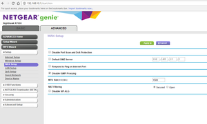

Picture is of speedtest.net. There is exactly one PC connected to the r7000, the PC doing the speed test using a Gigabit ethernet card and Cat6 cable. There is no QOS, no cameras running, nothing beyond the PC.
Plugging the PC directly into att&t a Pace 5268 port shows uploads exceeding 700mbps.
I renew my begging for any possible technical explanation.
