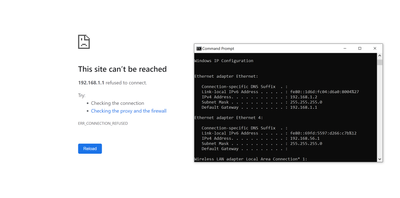

I am setting up a Nighthawk router model R6700AX and I've gone through the setup steps on the Nighthawk app through firmware updates. Once the firmware is updated I get "Logon timed out, please try a...

Why is the local IP address for your ethernet adapter 4 192.168.56.1? I would disable this adapter to be sure Windows is using the primary adapter connected to the router.

The gateway IP and routerlogin.net both refuse connection

Both routerlogin.net and 192.168.1.1 refuse to connect after the 10 second reset. I disconnected the router's WAN port too beforehand.
