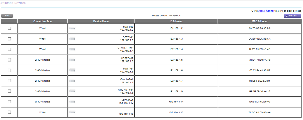

1. Router Connected Devices sees IP 198.168.1.6

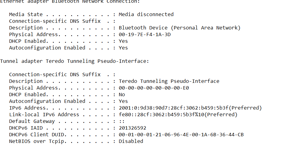

2. IP config /all issued on the T61 sees IPv4 192.168.0.10

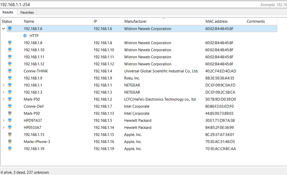

3. Advanced IP Scanner sees 5 IP address .6, .8, 10, .11 and .12
Earlier this morning the router's Connected Devices saw the same 5 IP addresses as IP Scanner. When I turned off the security chip in the BIOS the router then just displayed .6

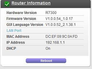

       What's the IP address of the router (LAN interface)?  (ADVANCED)

    > 3. Advanced IP Scanner sees ...
       And what are those IP addresses?

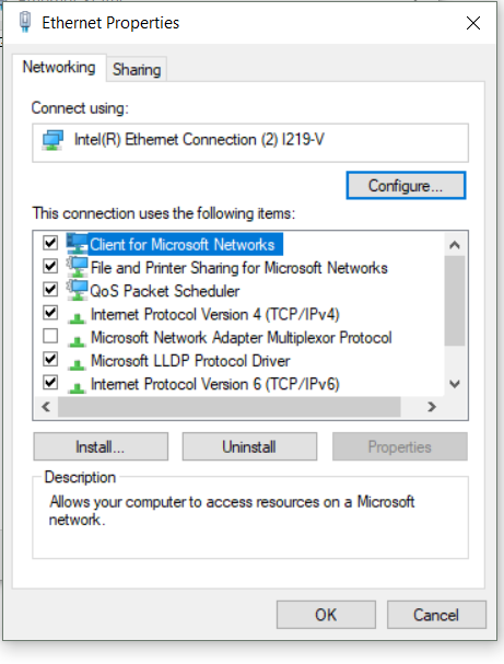

       Make sure that all these computers have Local Area Connection Status
    > Local Area Connection Properties > Internet Protocol Version 4
    (TCP/IPv4) Properties thing says "Obtain an IP address automatically"?

      1. I'm attaching a screenshot of what I believe to be the LAN IP.

      3. In my first post, the second screenshot, the 5 IP addresses associated with Wistron Corporation
      4. YES Internet Protocol Version 4 (TCP/IPv4) is checked off.
      However, the Properties tab says zip about "Obtain an IP address automatically". Where are you seeing this? This is the what I'm looking at:
