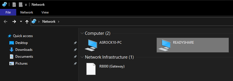

      I know the R8000 may not be the same however checking mine, however could have same code base, USB Drives are appearing after a reboot.
      Before a forced reboot:
      I noticed that Explore takes a bit more time to see it as I had to refresh the window a couple of times:

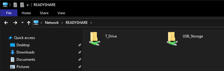

      After refeshing the window, the READYSHARE folder appeared.
      I connected a 3.0 drive as well as drive T:
      The drive in the 2.0 port has a LED and as the router was rebooting the LED turned OFF then back ON. Top USB LEDs on the router were ON as well.
      NTFS formated USB drives. 60Mb 2.0 and a 32Gb 3.0 USB drives.
