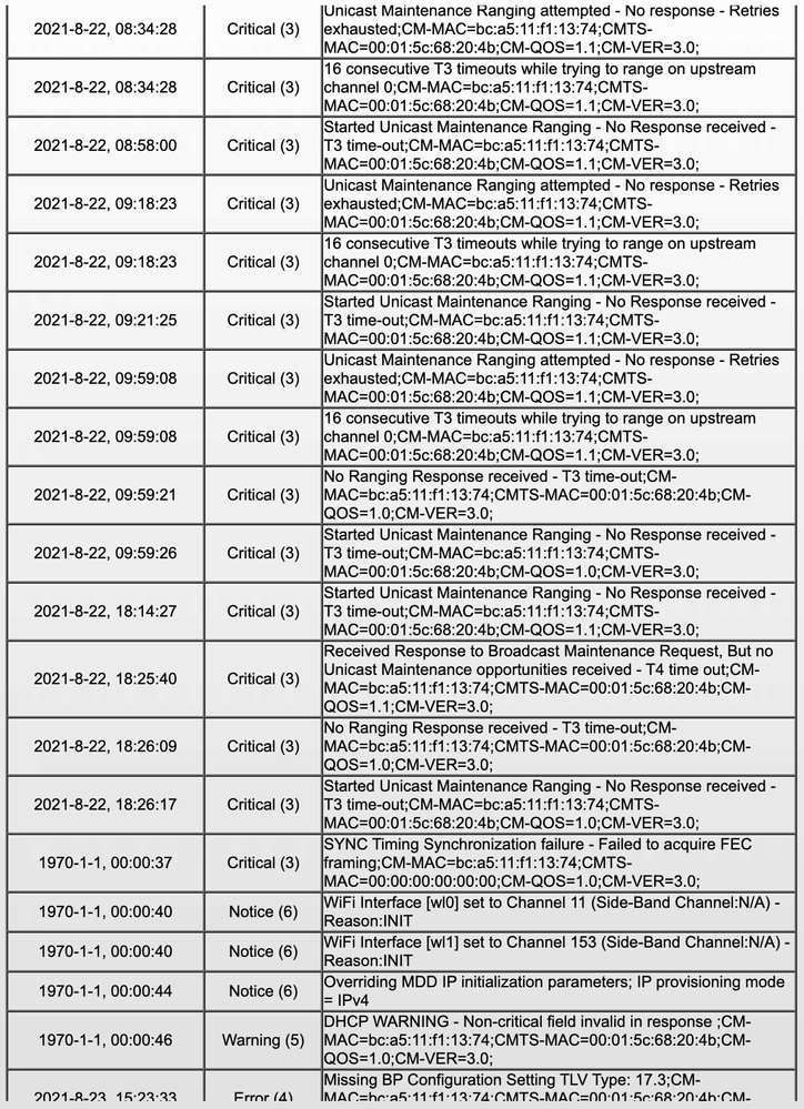

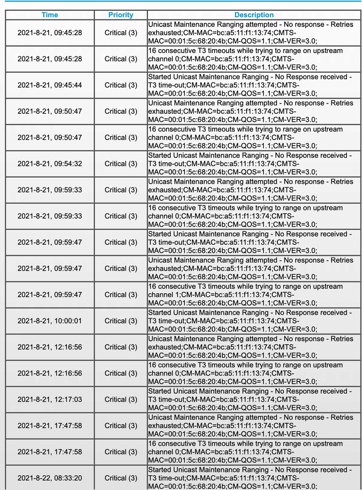

    • jguth21's avatar
      jguth21
      event log one
      • plemans's avatar
        plemans
        Your logs are indicating line issues.
        Do you have the cable connections page the shows snr/downstream/upstream values?
