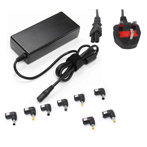

    Any generic adapter will work, as long as it has the right volts, enough amps, the right (+/-) polarity and a tip that fits the router. Some adapters come with a set of different interchangeable tips.
    Generic adapter
