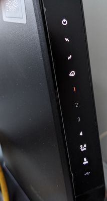

Modem/ router is connected to the TV via an Ethernet cable. Port 1. Sling TV on the TV works just fine however this light is solid Amber/ Yellow. When I connect a second Ethernet Cable Port 4 to a dedicated Ethernet Port on the notebook computer this light is solid White. Is one light supposed to be Amber/ Yellow and the other White? Both SlingTV on the TV works just fine (amber light) as does the Interenet connection (white light).TIA.

    phaedruspress wrote:
    >That's signifying its connecting at a 10/100mbps connection and not gigabit
    Thanks for replying. That would sound about right then if I am not mistaken. Port 1 amber light. The TV is about 3 - 4 years old and I would not expect it to have GIGabit capabilities.
    Most tv's aren't gigabit as streaming 4k only needs around 25-40mbps. so even a 100mbps connection will suffice and since its hardwired, you don't get the interference/network overhead of wireless. Glad to hear its working as it should :)

    Review the modems user manual for LED indication behavior information. Amber usually means 100Mpbs connection while WHITE is 1000Mpbs.
