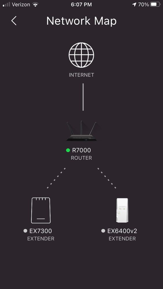

There are numerous posts on these issues.  My R7000 has begun developing more frequent internet outages over the last 6 months. Now the frequency is about every 10 days. The topology picture follows.
For a period, we were getting construction related, Periodic brownouts were driving the extenders nuts until I rebooted them.  I added a compact UPS for each of the R7000 and wifi extenders over a year ago and the extenders have been rock solid since. They never require rebooting. But as mentioned, I have more recent R7000 dropouts.
Booting the TM822 Telephony Modem doesn't help.  Rebooting the R7000 fixes everything.

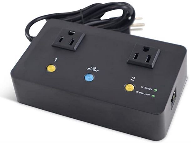

So, I'm adding a smart power strip switch to sense a few home IOT devices that should always be online, and power cycle the R7000, pending a host outage.
There are numerous switches that very similar and more expensive options for the same. We have reasons as many do that the home network should stay online. I wont know how all this helps for some time, but surely by mid-summer and I'll update.

  • Hmmm.... no pictures are showing up.  I apologize, but I think the content of the post is evident.  I should mention that whereas the smart power switch has 2 "smart sockets", I intend to only use one switchable socket, intended for the R7000.  I don't yet see a need to jokt the modem with power cycle hits until further indications.  Of course, the smart power switch will be plugged into the UPS.
