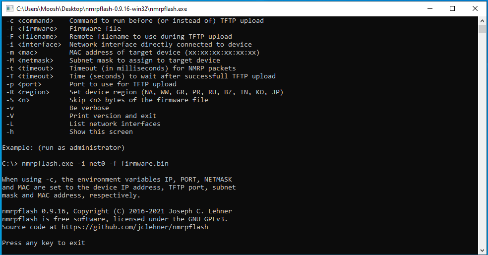

    and if that doesn't work, you can try using nmrpflash
    https://github.com/jclehner/nmrpflash

      I'm looking at nmrpflash currently. When I try and run it, the program starts and it never allows me to type anything in. Heres a pic of what I see. I never ask it to run that command. so all i can do is hit a key to exit the program.
