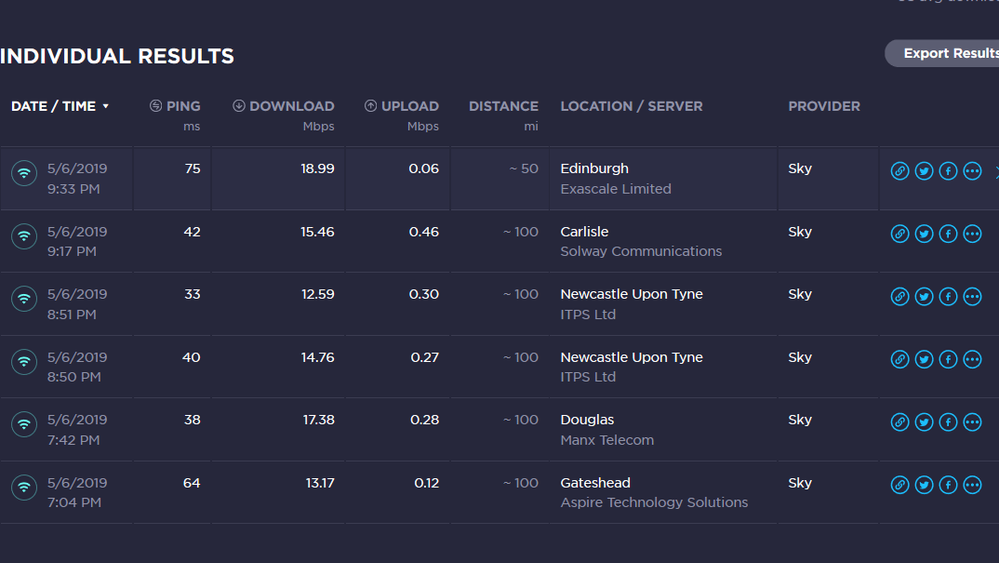

So I recently bought a Nighthawk X6 R8000 to improve my sky internet. after I followed the instructions and set it up I ran 6 speed tests where I averaged 15.39 download speed and 0.24 upload speed, this is better than what I had before but I don't think it is meeting what it should do and what it has been advertised to do and this is  the same wired and wireless. anyone able to help me here since I'm fairly new to this and I have been over fixes on youtube and other forums and none have worked so far. PLEASE HELP ME.

    Can't see what you posted, needs to be approved by a Moderator and can take some time for that to happen.

    • Fraser101's avatar
      Fraser101
      1. I don't know exactly what it should be at but the box says 3.2Gbps and it clearly is not reaching anywhere near that.
      2. I know that wired and wireless will have different speeds I meant that they both are still very low.
      3. and as far as what I've tried, have turned off QoS, traffic meter and parental controls as well as done a factory reset.
        Define 'very low' to what you expect and why you expect that speed?
        What is the ISP contracted speed?
        How are you measuring it?
        What is the Hardware involved (makes and models).
        Yes, Traffic Meter will cause slowdowns. QoS is probably not needed is ISP speed is 100Mbps or more. Parental Controls can slow it down. However what Security settings are you using? What SSID's are on what bands? What is your 'modem'? Are you getting better speed on one SSID or are all the same speed?
